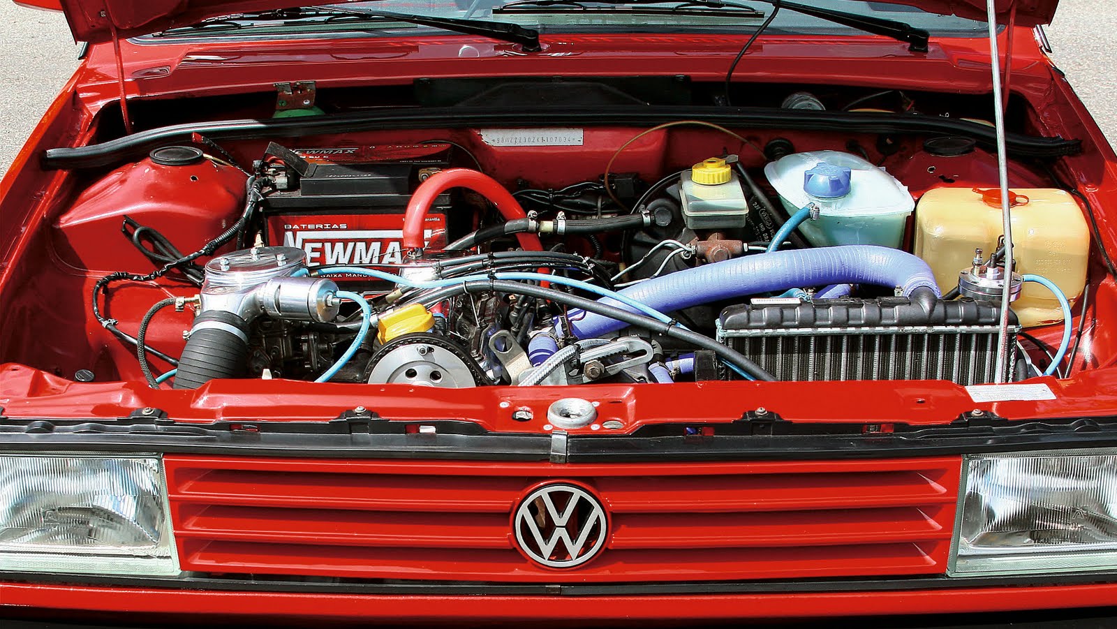

it is all the stereotypes like bears on the streets and balalaikaRodox escreveu:The problem that the cooling system of Brazilian cars are for tropical weather here ... already in Russia reaches -20°C in winter and less. Then using the radiator, cebolão of radiador and thermostatic valve of cars here the engine will be very cold and so will not reach the ideal temperature. The temperature here varies by region 1ºC in winter (southern Brazil) at 45°C in summer (Northeast).
O problema que o sistema de arrefecimento dos carros brasileiros são para o clima tropical daqui... já na Rússia chega a temperaturas de -20ºC no inverno e até menos. Então usando o radiador, cebolão e válvula termostática dos carros daqui o motor ficará muito frio e assim não vai atingir a temperatura ideal. A temperatura daqui conforme a região varia 1ºC no inverno (Região Sul do Brasil) a 45ºC no verão (Região Nordeste).
i see. I was thinking of using the passat radiator, but not your version of the passat, the generation before, the b1, that uses the same radiator as the gol does, if you find some one in a junkyard (is that the name for places to buy used car parts?), you can get all the tree places where the radiator is fixed on, so it will be easier to adapt. this passat:VASIL escreveu:danielgt I can not use my radiator, because between him and the grill is little room for Intercooler. if you move the radiator to the engine if there is no room for the fan. thanks for the video is what I was looking for. I think will not be a problem to make a similar attachment. interested in the gol the rear suspension, such as Passat 32b, or something else.if you mean the distance between the front and rear wheels, this is not a problem, it is only necessary to shorten the shaft. I did this because I used a six-speed gearbox from the Audi A4 is longer than the transmission of Pasat
300 km/hVASIL escreveu:I use a 6-speed transmission 01E not only to achieve high speed. it is stronger than 01a, 012.016 gearbox and has a comfortable gear ratios. but the speed is not a little 6 speed 352 at 7500rpm![]()
but I will not move so fast, if only once 300
I think this will be enough for this
